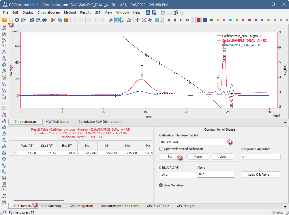

If the calibration file is not assigned to the method, the measured chromatogram will not have it linked either. To link a calibration file to a chromatogram do as follows:
  1. Switch to the GPC Results tab at the bottom part of the Chromatogram window.
  1. Click the Set… button , in the Open GPC Calibration dialog select calibration file you want to link and click OK.
  2. Check that the Calibration File (Peak Table) field contains the name of the calibration file .
  3. Note:
    When no calibration file is linked to a chromatogram, the field Calibration File (Peak Table) contains inscription (None).
  4. Save the chromatogram by selecting File - Save or clicking on .
