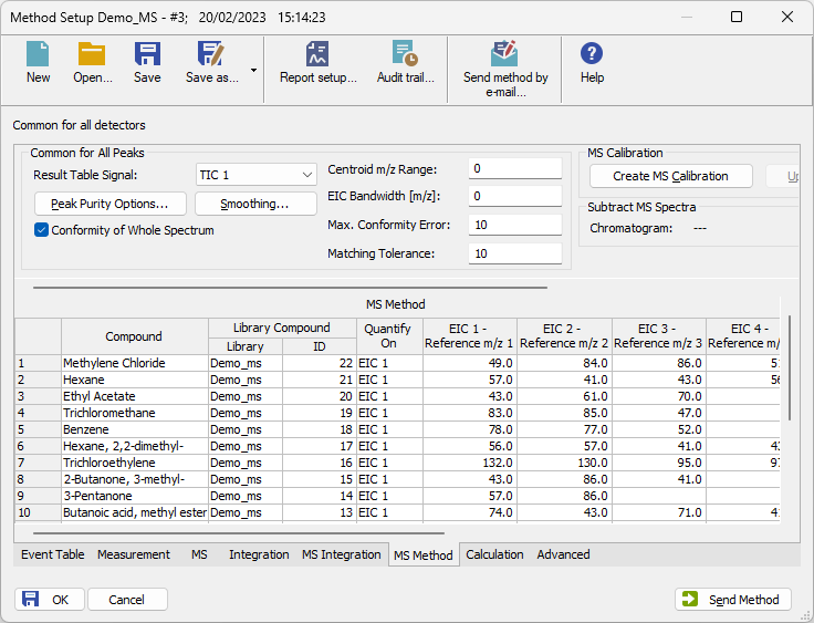

Method Setup - MS Method
Method Setup - MS Method is the method part holding information on the MS evaluation method. It contains the same fields and functions that are available on the MS Method tab in measured chromatogram and which is described in the chapter "MS Method".
Method Setup - MS Method tab
The development and possible modifying of the MS Method pretty much needs an interaction with the measured data. It is advisable to develop the method on a measured chromatogram and then save it as a method file, and measure rest of the chromatograms with it. Modifications in the Method Setup dialog may cause side effects which will not be, without the feedback from chromatogram graphs, clearly visible.
