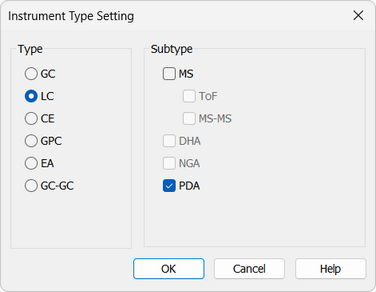

- Start Clarity and open the System Configuration dialog.
- Use the
button to enter the Instrument Type Setting dialog. Instrument types GC, LC, CE, and GPC can be combined with the PDA Extension. To enable the PDA extension, simply check the PDA checkbox on the right side of the Instrument Type Setting dialog. Note that the PDA license (p/n A29) must be purchased otherwise the checkbox is disabled.
- Save and close the System Configuration dialog using the OK button.
