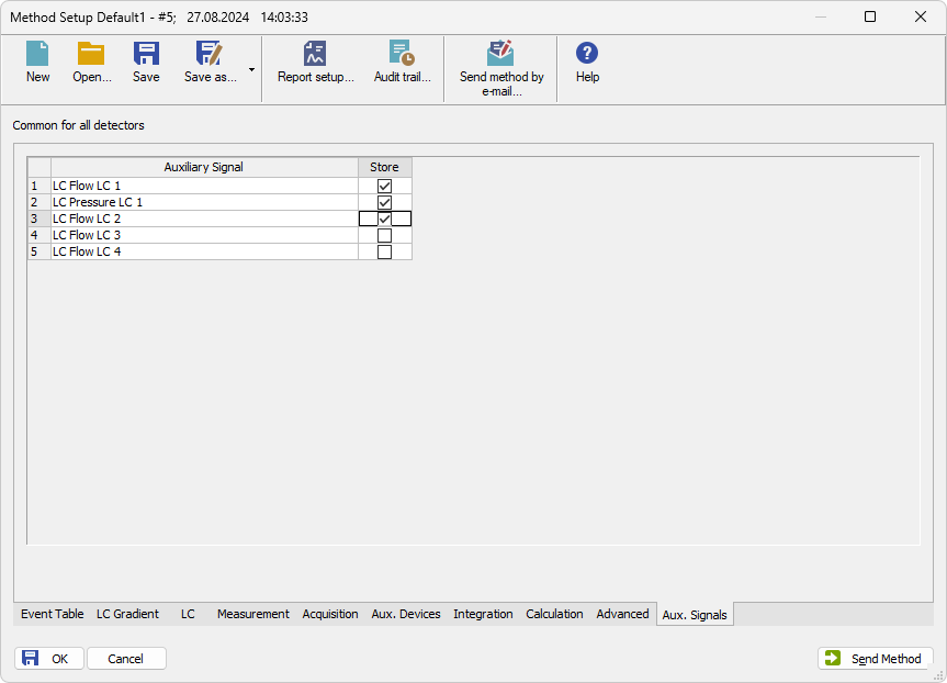

Aux. Signals
Sets the auxiliary signals storing and possible display. The tab is present only when the Auxiliary signals are available, and is common to all signals while performing multidetector measurement.
The presence of auxiliary signals is dependent on the directly controlled device. Some of these have auxiliary signals, some do not.
To display the auxiliary signals in the graph it is necessary to set their display in the Graph Properties dialog of the particular graph. It is, however, necessary to have the particular signal stored in order to be able to display it.
Method Setup - Aux. Signals
Auxiliary signal
List of available auxiliary signals.
Store
Check the checkbox to save the particular auxiliary signal to the measured chromatogram.
