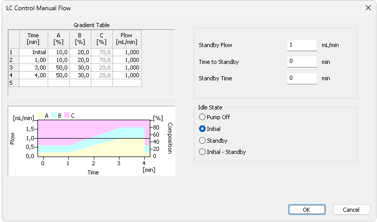

The LC Control Manual Flow dialog accessible through using the Modify Gradient… button from Device Monitor window allows the user to set a custom mobile phase composition and flow while the analysis is running. It resembles the Method Setup - LC Gradient tab in functionality.
The LC Control Manual Flow dialog is only available while an analysis is running. When it is invoked and the OK button is pressed, the original Gradient Table from the acquisition method is discarded and replaced by the Gradient Table from the LC Control Manual Flow dialog. Any such operation is recorded in the audit trail of the measured chromatogram.
