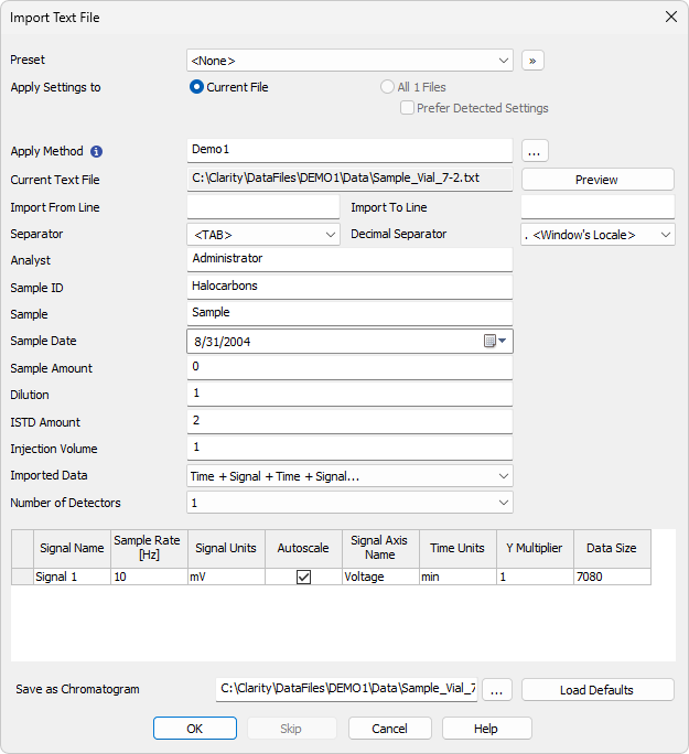

After selecting the chromatograms in the Open Files to Import dialog and pressing the Open button, the Import Text File dialog opens.
The conversion program determines the most suitable import setting according to the content of individual imported text files. Individual settings can subsequently be adjusted in the Import Text File dialog and saved for further use. Import is performed by the OK button.
If a number of files was selected in the Open Files to Import dialog, a further Import Text File dialog or Import AIA File dialog will open (according to the type of the next selected chromatograms) after clicking on the OK button.
Preset
When the same type of files are imported frequently, it can be useful and time-saving to save import settings for further use. In drop-down box on the left user can select from previously saved presets, by clicking button right to list the presets management menu will open. The menu contain commands for saving current setting (Create New...), Rename... or Removepresets. Presets are stored as part of Clarity Desktop settings.
Apply Settings to
This radio button group indicates whether all the settings below will be applied either to current file only or to all files imported at once. In case multiple files are imported at a time, and this radio buttons are set at Current File, the Import Text File dialog will be invoked for every file in the sequel. When Apply Settings to radio button is switched into the All n Files position, subsequent files will be proceeded with the same settings. By checking Prefer Detected Settings checkbox you can force Clarity to use setting detected from the imported file (where applicable).
Apply Method
Choose method whose parameters (integration table, attached calibration, etc.) will be applied into the imported chromatogram. By default, displayed method matches method in the Single Analysis dialog. Leaving this field blank applies default parameters.
Current Text File
The name of imported file including directory path.
Preview
This button will open the current file in simple text viewer. This can help user to identify exact meaning of particular columns when it's not clear from file suffix.
Import From Line
Sets the line of the file on which the data import should start.
Import To Line
Sets the last line of the file that should be imported.
Separator
Selects the sign by which the individual items are separated in the text file. <TAB>, <SPACE>, <COMMA> or <SEMICOLON> are available signs to choose from.
Decimal Separator
Separator of decimal points - <DOT>, <COMMA> or <Windows Locale>. Separator indicated in Windows (as <Windows Locale>) is used as the default.
Parameters entered to Import From Line, Import To Line, Separator and Decimal Separator fields will be applied on all simultaneously imported chromatograms.
Import Text File
Analyst, Sample ID, Sample, Sample Date, Sample Amount, Dilution, ISTD Amount, Injection Volume
These fields composing the chromatogram heading have the same meaning as described in the chapter "Single Analysis".
Imported Data
Time + Signal + Time + Signal... - Every chromatographic curve is saved in a pair of columns, in which the first one represents a time and the second one a signal.
Signal + Time + Signal + Time... - Every chromatographic curve is saved in a pair of columns, in which the first one represents a signal and the second one a time.
Signal + Signal... - Every chromatographic curve is saved in one column, where the values represent the signal only. The time basis is obtained from the Sample Rate field.
Time + Signal + Signal... - Time base is contained in first column, every next column represents a signal of one detector.
Number of detectors
Specifies the number of detectors for the import of multi-detector chromatograms.
Sample Rate
Selects the sampling speed in the number of samples per second (Hz). Select one of the speeds from the list corresponding to the speeds of your A/D converter or enter your own value.
Signal Units
Determines the units in which the signal values are stated.
Imported Data will not be parsed to recognize scaled units.
Autoscale
Sets the possibility to automatically scale the signal units in graphs.
Signal Name
Sets the signal name for further display.
Time Units
Determines the units in which time values are stated.
Possible values are: ms - milliseconds, s - seconds, min - minutes.
Minutes are entered in decimal format (e.g. 1.5 min. = 1 min. 30 seconds).
Y Multiplier
Sets the multiplier for scaling the data on the signal axis.
Data Size
Number of points of a curve.
This field cannot be adjusted. It serves only as referential check whether the import took place correctly.
Save as Chromatogram
Sets the name and location of the resultant chromatogram created after importing a text file. By default, the program will offer to use the original name of the imported file using the suffix *.PRM with a path to the directory of the current project.
To select another name and location for the resultant chromatogram, open the Save As... dialog using the button.
Load Defaults
Selects implicit values of all fields (i.e. returns the dialog into state prior to any changes made after opening).
OK
Confirmation of import.
Skip
Skips current file and proceed to subsequent one while importing multiple files.
Cancel
Cancellation of import.
