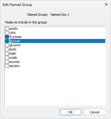

The Edit Named Group dialog allows users to create and manage named groups in the Calibration Table. Named groups are used to sum the amounts of already calibrated peaks for reporting grouped results.
To create a new Named Group, use the Calibration - Add Named Group command (or its icon). This opens the Edit Named Group dialog, where peaks can be selected for inclusion. All peaks present in calibration are available for selection, and are listed alphabetically. Unlike standard groups, a peak can be part of multiple Named Groups.
Edit Named Group
The name of a Named Group is set in the Calibration Summary Table, the same way as compound names. Named Groups do not have an individual compound tabs, as their purpose is solely to sum the amounts of other calibrated peaks.
To edit an existing Named Group, click the Edit... button in the Named Groups column in the selected Named Group row of the Calibration Summary Table.
