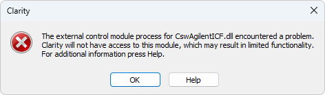

Some control modules run in a different process than Clarity itself. This way, it is possible to use memory more effectively and prevent problems due to exhausted memory for the 32-bit Clarity process.
If an external control module process encounters a problem, the following message pops up. Communication error is invoked, and it is necessary to restart Clarity before further usage to prevent unanticipated behavior.
External control module process error message

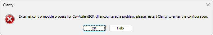

Until Clarity is restarted, it is not possible to enter the System Configuration dialog to prevent configuration corruption - the following message displays when trying to open the System Configuration dialog.
Entering System Configuration disabled error message
