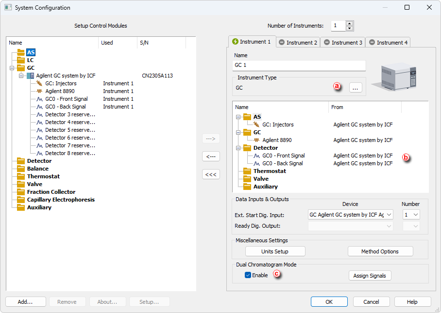

To enable the Dual Chromatogram Mode on an Instrument, set a supported Instrument Type (e.g., GC) in the Instrument Type Setting dialog. Assign at least two detector signals to the Instrument and check the Enable checkbox in the Dual Chromatogram Mode section .
System Configuration - Dual Chromatogram Mode

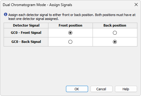

It is also necessary to assign at least one signal to both the Front and the Back position in the Dual Chromatogram Mode - Assign Signals dialog.
