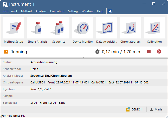

During measurement, in the Instrument window, the Chromatogram, Sample, and Sample ID rows are divided in half to display both the Front and the Back position contents. If the content for both position is the same, it is displayed only once.
The Injection row only displays the vial used for the Front position.
The display of the analysis works the same way in Clarity2Go: the rows are divided in half to display both the Front and Back position content.
