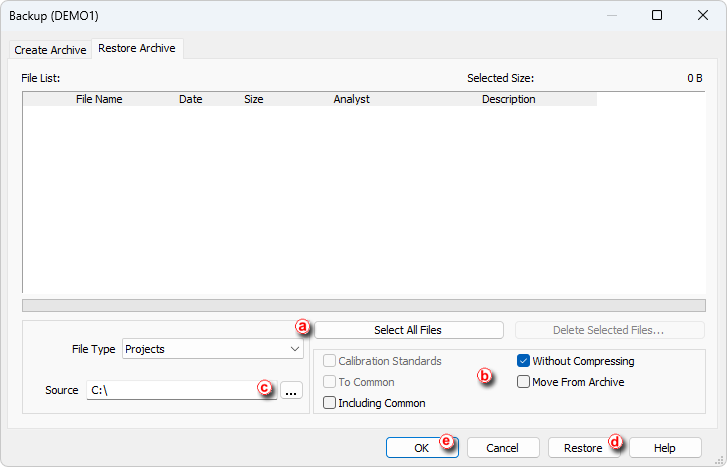

Restoring a project from an archive
  1. Open the Backup dialog by selecting Instrument - Restore... in the Instrument window.
  2. Choose the source directory and select the source file . Compressed files will have the .DGZ extension.
  3. Select Projects in the File Type option to restore a complete project directory.
  4. Choose from the following options :
    • Uncheck the Without Compressing option to restore all files from a compressed format.
    • Check the Move from Archive option to have the archived files erased after restoring them.
    • Check the Including Common option to also restore the COMMON subdirectory.
  5. Select the project or projects you wish to restore from the list. The Select All Files button will select all projects.
  6. Click the Restore button to restore the project or the OK button if you do not need to restore any more files.
Clicking OK will restore current selection.
