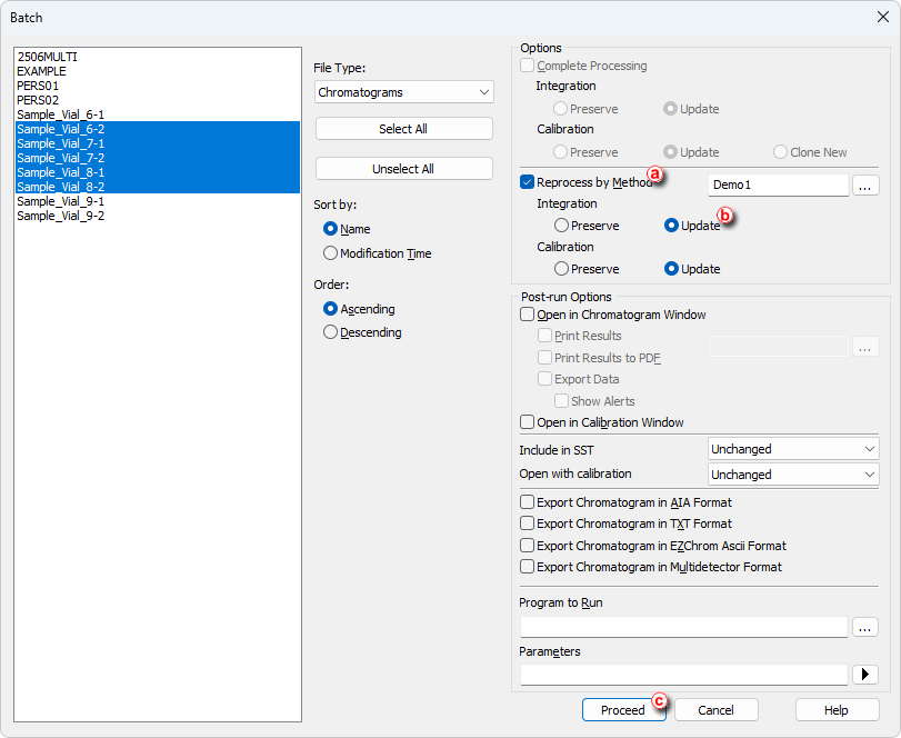

  1. Prepare your method with desired integration and linked calibration.
  2. Open Batch dialog by menu Analysis - Batch... from the Instrument window.
  3. Select chromatograms you want to reprocess (Alternatively, select sequence(s), depending on your File Type).
  4. Select Reprocess by Method and define your created method.
  5. Select Update Integration in case you want to change integration parameters as set in the defined method.
  6. Click on Proceed .

Now your chromatograms are reprocessed, with linked calibration file and amended integration parameters from the used method.
