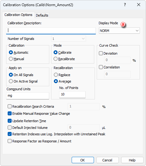

For both options set the calibration to the NORM Display mode, this ensures that Clarity checks that all the peaks are used for calculations and 100% Amount really corresponds to the whole sample.
- Set Display Mode to NORM ⓐ in Calibration Options dialog.

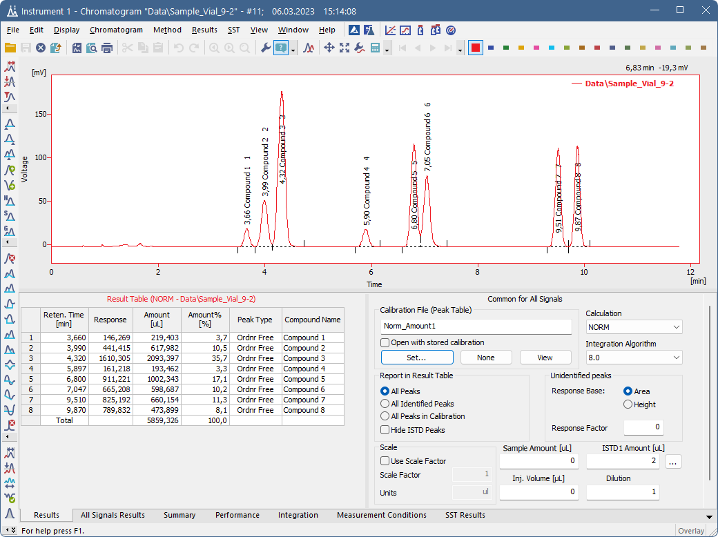

Figure below displays Result Table of a chromatogram with linked calibration that was created using the above mentioned method. Note different values in columns Area [%] and Amount% are caused by various values in Manual Response Factor column.

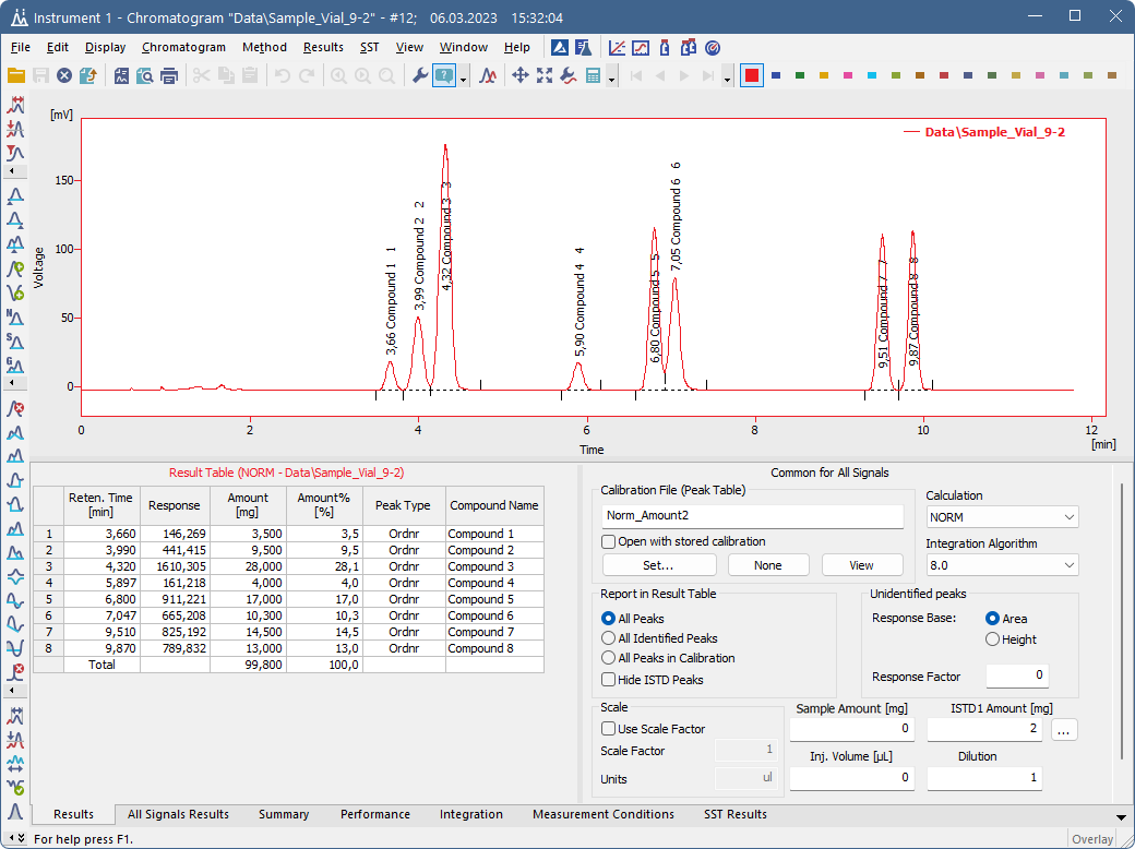

Figure below displays Result Table of a chromatogram with linked calibration that was created using the above mentioned method. Note different values in columns Area [%] and Amount% are caused by calculated values in Response Factor column.
