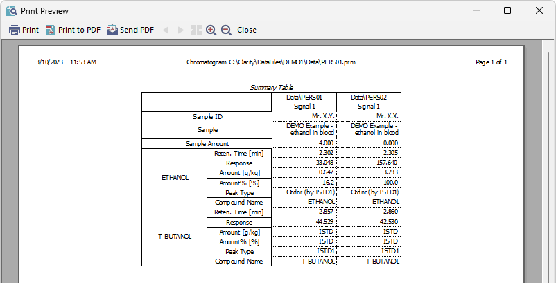

Printing the summary table
  1. Setup Summary table in Chromatogram window. For information on how to create Summary Table, see the chapter "Comparing the results from several chromatograms".

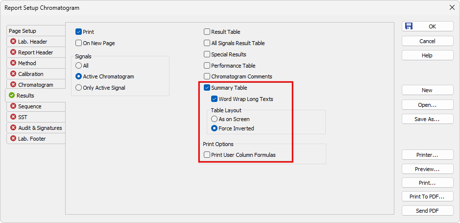

  2. Right-click in the Summary Table, if you want to change the visualization of the table, add a custom column, etc.
  3. Open the Report Setup dialog and check the Summary Table checkbox in the Results tab.
  4. It is also recommended selecting Word Wrap Long Texts and Force Inverted (table will be printed with inverted layout ignoring the on-screen layout which is more suitable for reports) options. Print User Column Formulas can be used when custom columns are included in the table.
  5. The results for all opened chromatograms will be printed.
