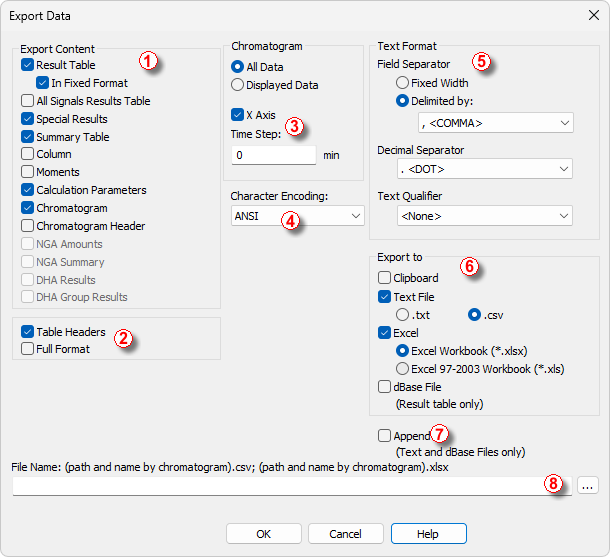

  1. Open Export Data dialog from Instrument window by using Setting - Export Data...
  2. Select which data you want to include in the exported files in the Export Content group . Detailed description of these fields can be found in the Export Data topic.
  3. Select whether you want the tables exported with headers and/or in the full format .
  4. Select whether the exported chromatogram data will contain time column or not. If you intend to perform bunching for the exported data specify the time period for the bunching .
    The mean value for selected Time step period is calculated as a sum of the highest YMax and lowest YMin signal curve value found within each Time Step period divided by two - (YMax+YMin)/2.
  5. Select the character encoding to be used (ANSI or Unicode (UTF-8)) .
  6. Select the appropriate text formatting for the export .
  7. Select the format or formats to which the data will be exported. You can choose any number of export types at the same time .
  8. Select whether the exported data should be appended into an existing file (in this case file name must be filled in) or exported as a new file (leave the file name empty as shown bellow).
  • This setting will be used for automated data export from Sequence or Single Analysis.
  • To manually export data you can invoke the same dialog from Chromatogram window by using File - Export - Export Data... command or icon. In this case dialog also includes Export button which can be used the export data from currently opened chromatogram.
