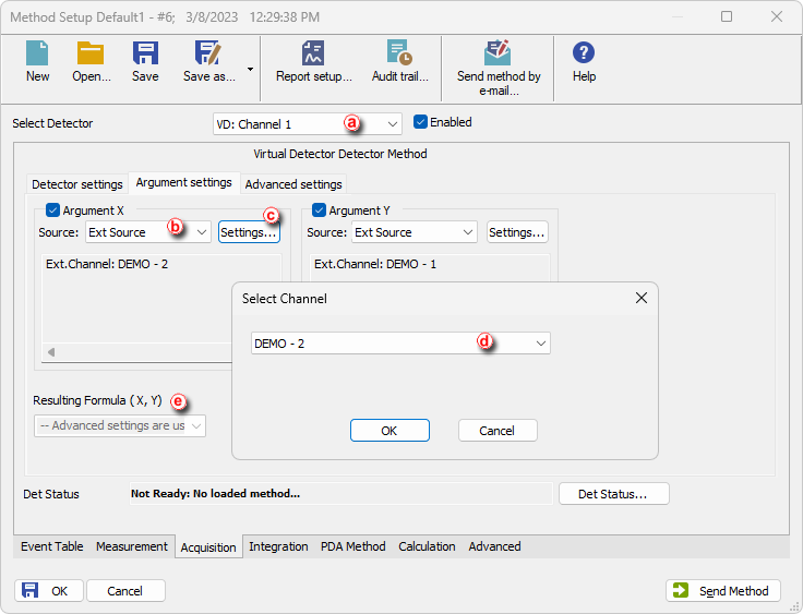

  1. Add the Virtual Detector as well as your dual wavelength detector to the instrument, if not already present, based on chapter Adding a new device.
  2. Open the Method Setup dialog and navigate to Acquisition tab.
  3. Select VD: Channel 1 in the Select Detector drop-down list .
  4. On the Argument settings tab, tick the Argument X checkbox, select an Ext. Source , then click on the Settings button , select the appropriate detector Channel and click OK .
  5. Repeat the same steps for Argument Y and select the second channel from the detector.

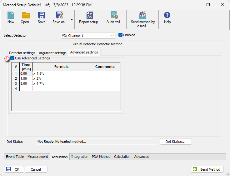

  6. If want to use the same signal ratio for entire analysis you can fill in the Resulting Formula field with the proper formula. If you need multiple formulas for different times skip this step and continue with the next one.
  7. To set multiple formulas for different time intervals navigate to the Advanced settings, check the Use Advanced Settings checkbox and fill the time table as needed.

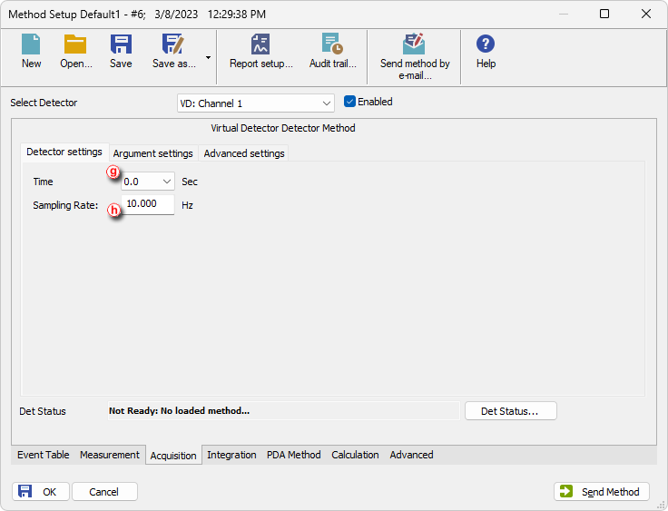

  8. On the Detector settings tab, set the Time to 0 to avoid distortion and fill Sampling Rate equal to the actual detector sample rate.
