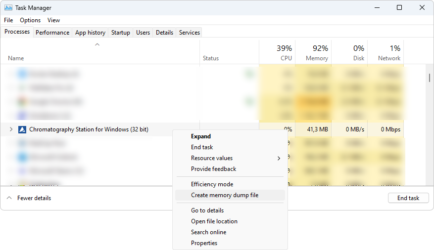

  1. Run the 32-bit Task manager with the option Run as administrator (Clarity is a 32-bit process thus the 32-bit Task Manager must be used), it is located here: C:\Windows\SysWOW64\Taskmgr.exe.
  1. Locate the Clarity process, right click on it, and in context menu select Create memory dump file.

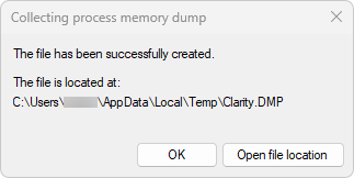

  1. A dialog informing that the dump has being successfully created will pop up, including information on where it is located.
  2. Send this file to our support team either via email support@dataapex.com, or the Support Request form on our website.
