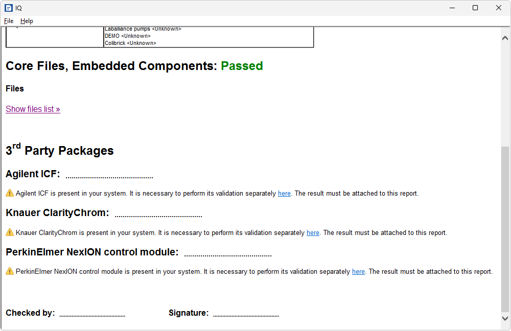

- After the installation has been completed, you can open IQ by searching for
IQ Report in the search field of the Start menu. Alternatively you can start IQ by using C:\Clarity\Bin\IQ.exe. - If the installation has been correctly performed, the status should read: "Installation Qualification Test: Passed".

You can use Show files list to display list of all validated files and search for the ones that are causing issues.
Some driver packages have standalone IQ that must be performed separately by clicking here in given section. Clarity IQ is NOT valid unless IQ of all components passed and reports are stored together.
