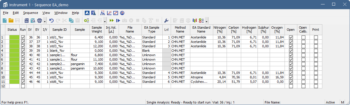

Sequence window
Sequence window now contains new columns of the elemental compound percentages in standards, i.e. Nitrogen, Carbon, Hydrogen, Sulphur, Oxygen.
Sequence window
The EA Sample Type column (which replaces the Sample Type column in Clarity standard mode) specifies the calibration standards, the available entries are:
EA Sample Type entries:
Sample Type | Description |
Unknown | For unknown samples. |
Standard | For calibration standards. Sample Amount, Level (Lvl.) and EA Standard Name fields must be filled in. The composition columns will be filled automatically from the Standard Table. |
Blank | For blank samples. The response determined will be used on Level 21 of the calibration with amount 0, which will be counted to the calibration. |
Bypass | Analysis will be performed, but no result chromatogram will be stored. This is useful for running the column-cleaning or equilibrium-setting sample, where results are not desired, but the run must be performed to achieve the required state. |
The Method Name column contains the method name for the current method. This method is automatically set for all rows in the sequence and can't be changed during the running sequence as the column is disabled.
To change the method while the sequence is running, stop the sequence, change the method in any not measured row and resume the sequence. Only an user with the access right to Select Method can select another method.
