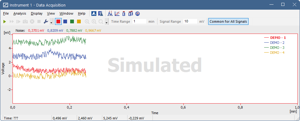

The title "Simulated" is displayed. The corresponding Instrument only displays a simulated curve in the Data Acquisition window.
▌Reason 1: You are using Clarity Demo version.
Clarity DEMO
Solution:
Check whether the title DEMOis in Clarity window header. If so, uninstall the demo version and install the full version of Clarity.
▌Reason 2: A DEMO detector is allocated to the Instrument.
