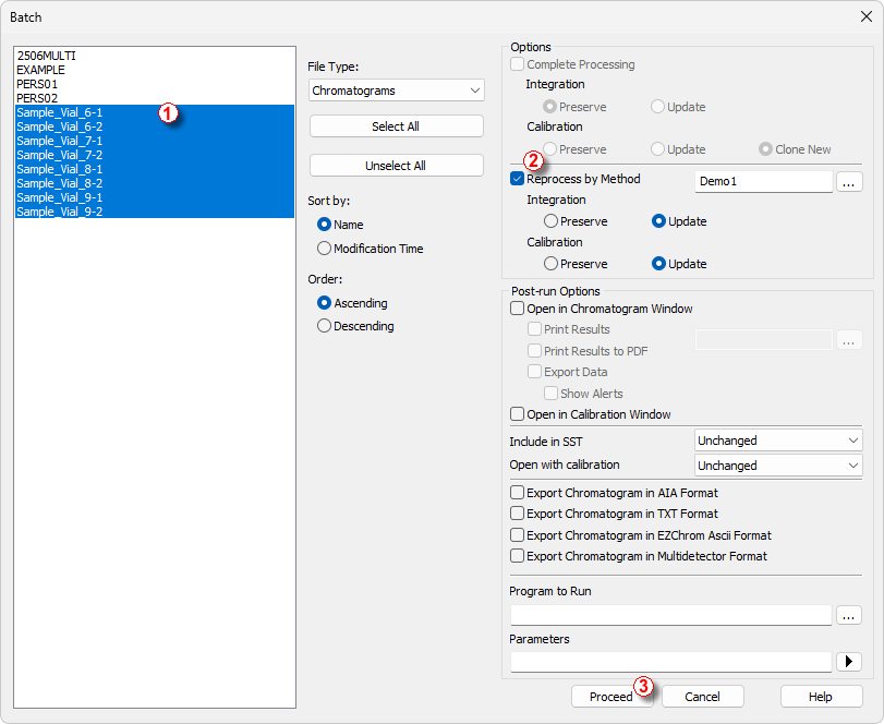

  • Go to the Instrument window and use the Analysis - Batch... command.
  • Select the files to be reprocessed in the left part of the dialog (Fig "Batch dialog with selected chromatograms"); multiple files can be selected by left-clicking them while holding the Ctrl or Shift key. For the demonstration, select all files with the names SAMPLE_VIAL_X-Y to be reprocessed.
  • Check the Reprocess by Method checkbox, select the method to be used for the reprocessing (the one that has the correct calibration linked), and in Calibration part of the Options select the Update.
  • Click the Proceed button.
All selected chromatograms will now be linked to the calibration based on the selected method.
You can reprocess files only from the currently opened project.
