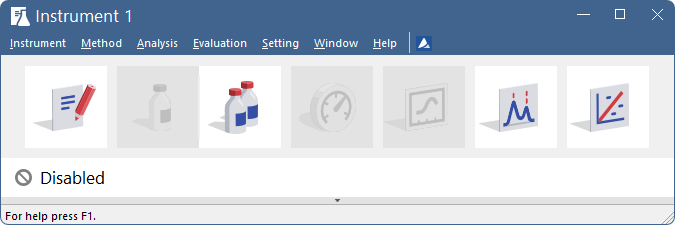

Data Acquisition - Disabled
Data Acquisition disabled
The "Disabled" label appears, and the Single Analysis dialog and Data Acquisition windows are not available. Other manifestations of this error are also: Method Setup - Acquisition tab missing, Run, Stop, and Abort commands non-functional in the Sequence window.

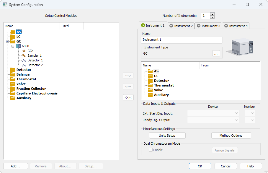

â–ŚReason 1: No detector is allocated to the Clarity Instrument.
Detector not allocated to the Instrument
Solution:
Open the System Configuration dialog from the Clarity window using the System - Configuration... command and check the tab of the corresponding Instrument - Instrument X. If it has no allocated detectors, add them.
In the list on the left side of Setup Control Modules, select the correct detector, and drag it to the corresponding instrument section on the right.
If the appropriate detector is not in the list, add it using the Add button and repeat the previous step.
If this does not help, continue to Data Acquisition - Disabled topic in the User Guide, where also more complex reasons for this issue are explained.
