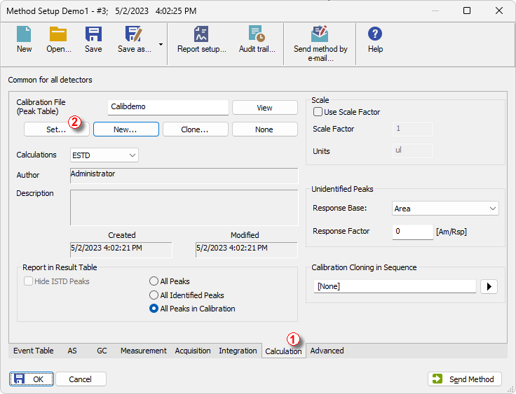

  • Return to the Instrument window and use the Method - Calculation... command to open the Method Setup dialog directly on the Calculation tab as shown on Fig "Method Setup - the Calculation tab". Alternatively, open the Method Setup by clicking on the icon and then move to the Calculation tab.
  • Use the Set... button to select the calibration file and link it to the method.
  • Exit the Method Setup dialog using the OK button. Clicking this button saves this change to the method.
  • Any chromatograms measured using this method in the future will be automatically linked to the chosen calibration.
