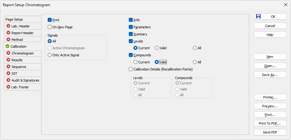

Determines the contents and layout of the calibration printout.
Report Setup - Calibration
Determines which signals (detectors) will be printed when using a multi-detector configuration. Include either calibration parameters from all signals (All) or only the parameters from the active signal (Only Active Signal).
Prints the name and description of the calibration.
Prints the parameters from the Calibration Options dialog.
Prints the Calibration Summary Table from the Calibration window.
Prints Calibration Summary Table(s) for specified levels including the section related to the active level and signal only.
Prints only the table which refers to the current level.
Prints only tables of levels which contain at least one valid compound. A compound will be valid when the Response and Amount columns differ from zero and the Used checkbox in the Calibration Summary Table has been checked.
Prints the table for all calibration levels (including blank) irrespective off the fact if the level has any valid data.
Prints calibration tables from tabs of individual compounds including the calibration graphs. Information concerning individual compounds is printed on separate pages.
Prints only the table and graph of the current compound.
Only tables and curves of compounds having at least one valid level will be printed. A level is valid when columns Response and Amount in the calibration table of compound differ from zero and on the same level the parameter Used has been checked.
Prints calibration tables and graphs for all compounds.
Allows to print the details of calibration points for the selected combination of calibration levels compounds.
Defines which levels will be used for the display of calibration point history. Options are Current, Valid and All.
Defines which compounds will be used for the display of calibration point history. Options are Current, Valid and All.
