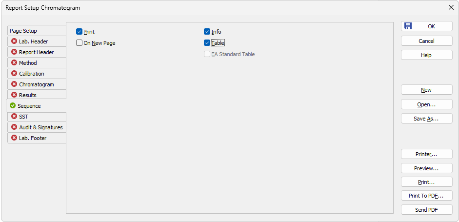

Sequence
Tabs: Page Setup - Lab. Header - Report Header - Method - Calibration - Chromatogram - Results - Sequence
Determines the parts of the sequence displayed in the report.
Report Setup - Sequence
Info
Prints the description of the sequence - namely the Sequence Name and Description, name of the User Account used to create the sequence, date and time when the sequence was Created and Modified, the Type of the sequence (Active or Passive) and the Idle Time parameter set. All these parameters are described in
Table
Prints the sequence table.
