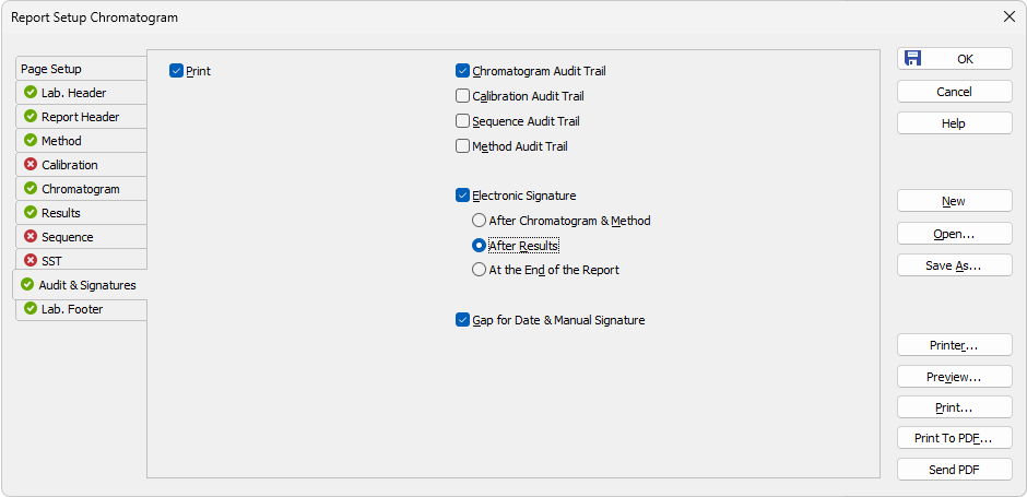

Audit & Signatures
Governs the print of local audit trails and electronic signatures.
Report Setup - Audit & Signatures
Chromatogram Audit Trail
Prints the operations made with the Active Chromatogram logged in the Chromatogram Audit Trail window.
Calibration Audit Trail
Prints the operations made with the Calibration file logged in the Calibration Audit Trail window.
This option invokes print of complete audit trail of Calibration linked to current active chromatogram if the print is requested from Chromatogram window.
Sequence Audit Trail
Prints the operations made with the Sequence logged in the Sequence Audit Trail window.
This option invokes print of complete audit trail of last opened sequence file in Sequence window if the print is requested from Chromatogram window.
Method Audit Trail
Prints the operations made with the Method file logged in the Method Audit Trail window.
This option is solely operational in case the print is requested from Method Setup dialog only. If the print is requested (with this option enabled) from another location than Method Setup dialog (for example from Chromatogram window) there will be nothing printed.
Electronic Signature
Determines the placement of the electronic signature:
After Chromatogram & Method
Places the signature after the chromatogram and its method.
After Results
Places the signature after the result tables.
After the End of the Report
Places the signature at the end of the report.
Gap for Date and Manual Signature
Prints a pre-printed blank line at the end of the report so that the date and signature may be filled in by hand after the printout.
Printing the entire station's logs (Session Audit Trail and Daily Audit Trail) can only be done directly and manually from the Audit Trail window using the File - Print command.
