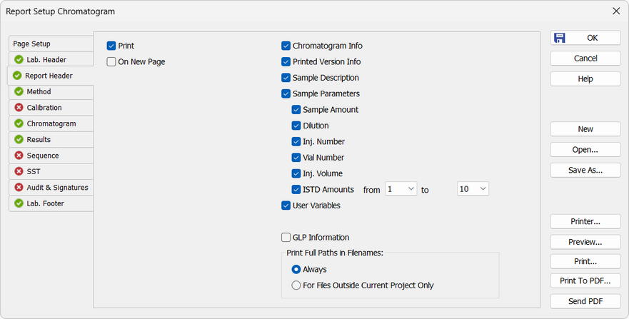

Report Header
Tabs: Page Setup - Lab. Header - Report Header - Method - Calibration - Chromatogram - Results - Sequence
Selects the information that will be used in the report header. Everything but some parameters from Printed Version Info (and it’s GLP Information) is printed from chromatogram. These information may include the origin of the chromatogram, date and time of analysis, user account used, calibration file name, name of the report style, data from the chromatogram header or directory where the chromatogram is stored.
Report Setup - Report Header
Adds the detailed info about the origin of the chromatogram to the printed report. Following parameters are added:
Filename - shows the filename of the chromatogram.
Origin - defines whether the chromatogram was Acquired, Imported or Self created by mathematical operations.
File Created - shows the date and time when the chromatogram file was created(according to the Windows file system).
Acquired Date - shows the date and time when the chromatogram was acquired(the end of acquisition as stored in the chromatogram).
By - displays the name of the user account used to acquire the chromatogram.
Original Project - shows the name of the original project used to acquire the chromatogram, such information is stored within chromatograms since version 8.3.
Adds the detailed info about the print to the printed report:
Printed Version - shows the date and time in which the chromatogram version being printed was saved, thus enabling to trace the given chromatogram version.
Report Style - shows the report style used to print the report.
Calibration File - shows the name of the calibration file used.
Printed Date - shows the date and time when the report was printed.
By - displays the name of the user account used to print the report.
Project - shows the name of the Project currently opened on the Instrument when printing of respective chromatogram took place.
Adds the detailed info about the sample to the printed report. This info comes from the chromatogram header and is defined in the Sequence or Single Analysis dialog. The fields reported are Sample ID and Sample.
Adds the detailed info about sample parameters of the respective chromatogram to the printed report:
Sample Amount - shows the Sample Amount value as on right side pane of the Chromatogram - Results and Chromatogram - All Signals Results tabs.
Dilution - shows the Dilution value as on right side pane of the Chromatogram - Results and Chromatogram - All Signals Results tabs.
Inj. Number - shows the serial number of the injection as in respective Sequence if chromatogram was measured using sequence.
Vial Number - shows the vial number in ordinary format from Sequence or Single Analysis relevant to printed chromatogram.
Inj. Volume - shows the vial injection volume value as on right side pane of the Chromatogram - Results and Chromatogram - All Signals Results tabs.
ISTD Amounts - shows ISTD1 ... ISTD10 (internal standards) values. Two dropdown menus to the right of the ISTD Amounts allows to set a range which ISTD values should be included in the printed report. For example, if there are selected values 3 and 5, there will be printed values for ISTD3, ISTD4 and ISTD5.
In GPC Extension, there is an extra section GPC Parameters that adds the detailed info about GPC parameters to the printed report. This info comes from the chromatogram header and is defined in the Sequence or Single Analysis dialog. The fields reported are K and Alpha.
Adds the detailed info about Analysis and Method user variables to the printed report. This info comes from the chromatogram header and is defined in the Sequence, Single Analysis, Method Setup or Chromatogram window. The fields reported are Name and Value.
To print Method user variables from Method Setup window, use the Calculation Parameters checkbox on Method tab. The Analysis user variables set in Sequence window can be printed in the table from sequence tab.
Determines the format of filenames by switching on and off the full path in the name of the files in the given project directory. For files outside of the project directory the full path is always printed.
The full path will be printed for all files.
For Files Outside Current Project Only
- The files that are in the appropriate directory specified by the project will be printed without path.
- Files that are in any other directory or subdirectory will be printed with full path.
Adds the information about the computer, Clarity version and methods used for obtaining the printed information to the Chromatogram Info and Printed Version Info sections. If none of these sections is selected for display, the GLP Information checkbox will be disabled.
