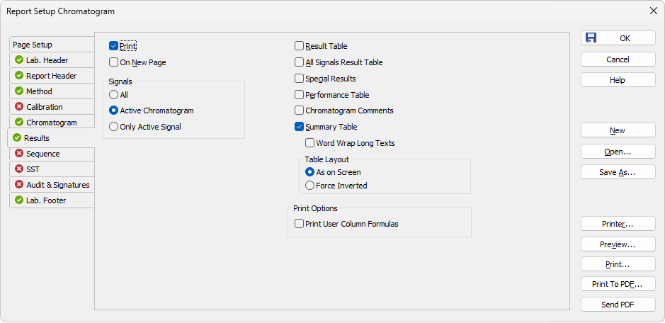

Determines the content and layout of the printed analysis results.
Report Setup - Results
Determines which signals (detector) information will be printed when using a multi-detector configuration. You can choose to include either method parameters from all signals of all chromatograms (All), all signals from active chromatogram (Active Chromatogram) or only the parameters from the active signal (Only Active Signal).
Result Table
Prints the Result Table from the Chromatogram - Results tab.
All Signals Result Table
Prints the All Signals Result Table from the Chromatogram - All Signals Results tab.
Prints special Result Tables generated by some control modules such as Virtual FC module.
Performance Table
Prints the Performance Table from the Chromatogram - Performance tab.
Chromatogram Comments
Adds the chromatogram comments entered into the Comments dialog from the Single Analysis or Sequence dialog or from the Measurement Conditions tab of the Chromatogram window to the report.
Summary Table
Prints the Summary Table from the Chromatogram - Summary tab.
Enables long texts to be broken so the text may continue on the next line.
The option As on Screen will print the Summary Table exactly as seen on the screen whereas the Force Inverted option will invert the Summary Table (rows will be shown as columns and columns will be displayed as rows) so the Summary Table may better fit to page.
Defines additional options for printed report.
Adds calculation formulas used in added User Columns including User Variables at the end of the appropriate table to be printed.
In the GLP mode, formulas are printed automatically, even if the checkbox is disabled.
